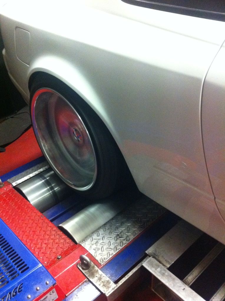

Couple more interior shots :)
Also, found some mad old photos of the car drifting in Japan!! This car has some history!
And finally, Greg at ProTuner mapped the car on Thursday. Its making a safe 355bhp and 360ftlb torque! :D
Very very very happy with the car! :)
