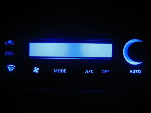

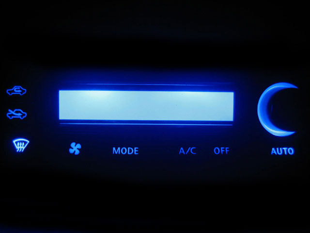

there are 5 bulbs in aac unit and there are two type of lighting schemes:
cars manufactured before 10/2000: 3 medium-sized bulbs, 2 small-sized
after 10/2000: 5 medium sized bulbs.
the bulbs are rated 1-2 watts each and have some sort of blue-сolored rubber emm... condom on them lol. so if you replace it with bulbs take it into account.
here is socket images (the M size is T5):
before and after 10/2000
