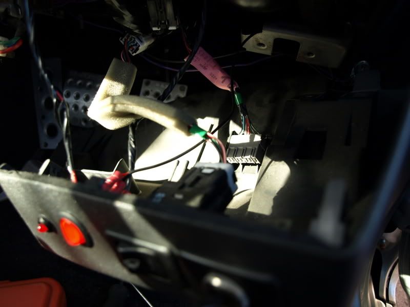

Thanks for the info ok i think i found the relay uploadin pics now.
I pulled out the plug thing and looked, wires 'seem' fine but i couldnt figure out how to get the actual relay off the metal bracket, didnt wanna snap it :S
I 'presume' the entire black box thing is what i need swapped but does it just pull out towards the back of the car direction?

You can see here the bit i pulled out guessin this was the right box.
Also found a heap of cables/wires/plugs not attached doing anything >_<
Cheers for this guys, not being able to indicate just feels 'odd' lol
P
Pazz
Think you will find the black thing, as in what the conector goes into, is the relay. But that connector doesnt exactly look like a normal connector. Never having done this before I cant really help you too much. Just look around it all very carefully before giving it a yank! lol
