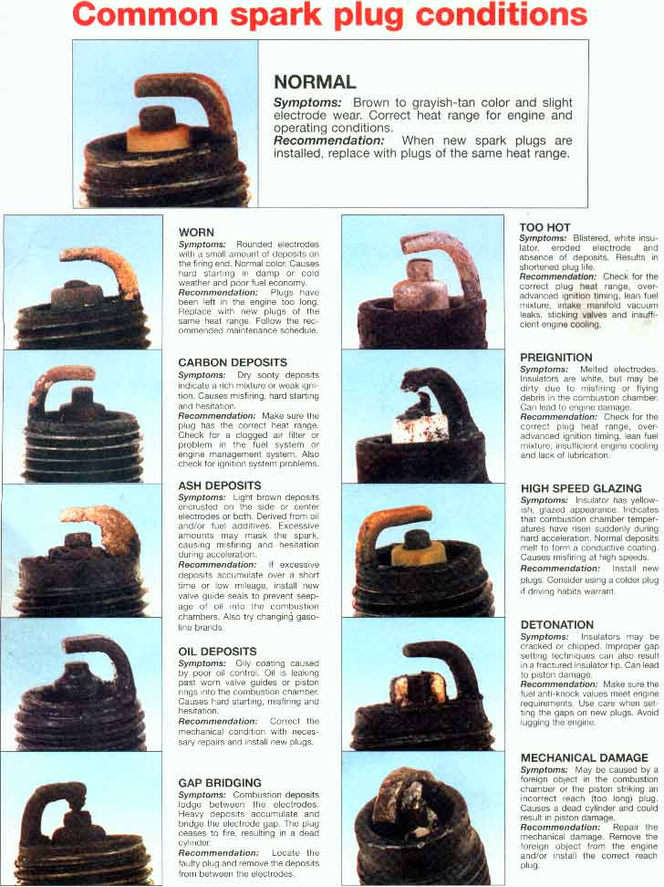

look at your plugs, if they are black and sotty looking they you are running way too rich and wasting fuel, if there is more of a browning then your car is running fine you just have a heavy foot, no crime, if you want a fast car then expect it to use fuel, simple really

ya, I should check my plugs first as spoonman said, I havent really drive fast with this car thou.
