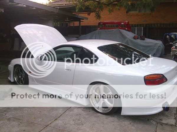

18 x 9 +12 running greddy type S as well
I'm sure they fit yours fine :)

ichi-go, thats a hot s15, are those 18*9 +12 all around or just the fronts?
7 January 2007
699
Perth, Wait Awhile
18 x 10 +22 B clearance will be fine for the rear.
That's just the front mate. Rears are still waiting for 19 x 9.5+12. Yeh one hot 15 that's for sure!
