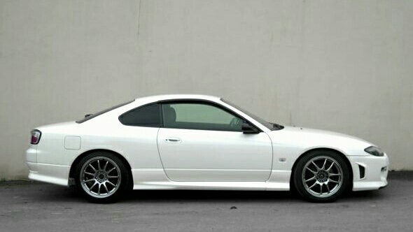

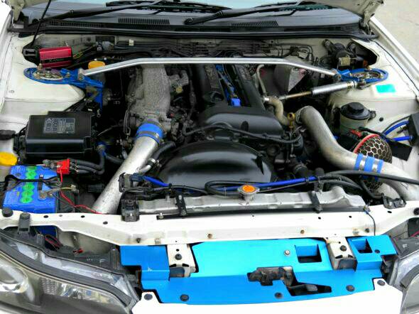

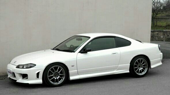

Spec list I was given
Spec R (Aero)
89,000 miles
WORK alloys
Trust titanium exhaust system
NISMO clutch
NISMO rear strut brace
NISMO pedal box
NISMO downpipes
BC coilover suspension
Project Mu braided brake lines
Drilled and grooved brake discs
Uprated pads
Uprated FMIC
Uprated radiator
Uprated front tie arm chassis brackets
CUSCO cooling panel
CUSCO strut brace
Short shifter
Greddy boost controller
HKS air filter
HKS actuator
HKS idle stabiliser
PIAA fogs lights
TOMEI manifold elbow
Splitfire coilpacks
X-power ignition amp
Engine damper
HKS boost controller
BLITZ turbo timer
LED rear lights
Ganador style wing mirrors
Basic pictures, and not sure how accurate the spec is as it says 2 boost controllers. Going down Friday to hopefully pick it up.
