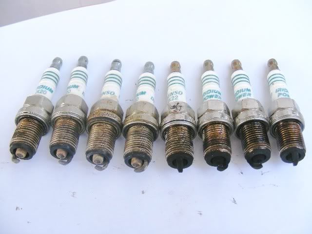

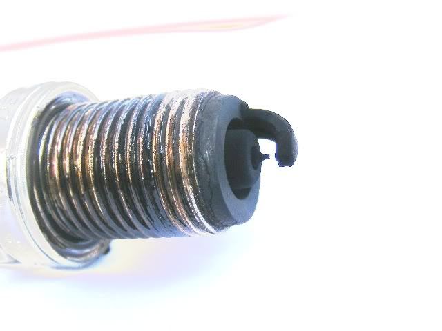

Todays a holiday. Had some time to remove and inspect the spark plugs. Denso IK22. Here's how it looks after 1 year of hard wangan.
I kept the old four plugs on the left IK20 when I was using stock ECU and the four on the right after tuning with Power FC...

Hehe, hey gunner, :wave:
Those pictures look like you have the bandits in your hands what....change and go for NGK R7118-8 plugs bro. Dun belive all the hype on iridium and stuff. These are grade 8 plugs and their sold at ST wangan who also have a dyno so you can do an all in one. Get them gapped correctly...not the factory 0.9mm, but something lesser, let the experienced mechs decide based on your mods.
I used these plugs for 30K kms already since owning my baby and ecah time i check, nothing more than a light layer of carbon and the grooves are clean. And i use my s15 as a proper daily driver so i vouch for it well.
Also, id strongly recommend that you change to MINE's VX rom. IMHO its just as customisable as the Power-FC and its programmed in Japan for the specific mods that you have. Judging that yours is a typical stage 1 car (FMIC, Z32MAF, UPRATED FUEL PUMP, INJECTORS etc). All you have to do is list your mods when you order the ECU and Mr. Niikura and his team will do a max safe map for you. They have done some cars in Malaysia so they're quite familiar with our atmospheric conditions. And the best part is, as you add your mods, you can send the ecu back for further tuning. The only downside is the travel time of sending and receiving the ecu. You can also specify rev limits and max speeds to further help the tuning process. The entire thing is GURANTEED furthermore and from a top tuning house like MINE's, thats assurance money cant buy. My basic set for uprated injectors 740cc cost me only RM3500 (inc delivery), preset for max boost of 0.9 bar. Dyno test 237bhp at 6400 rpm, and 288nm tq at 4300 revs. FC is 12.5km to a litre. I normally pour 50 litres and it gives me 630kms before first yellow light. Currently im asking them if they can remap the ecu for 97
