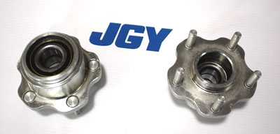

You want the part that is just to the left of the brake disk. The diagram you have does not give you the complete part #, a Nissan # will look like this: 40200-5L310 The diagram you have only lists 40202 that isn't corect. Here are what hubs look like...
and here are front spindles... don't order these
