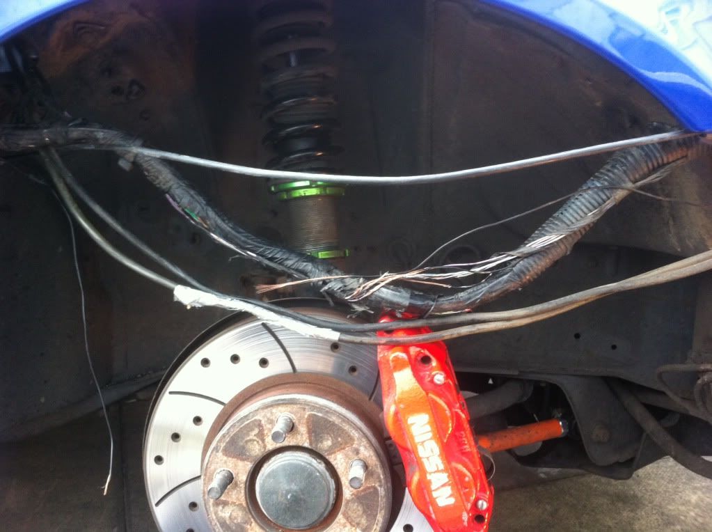

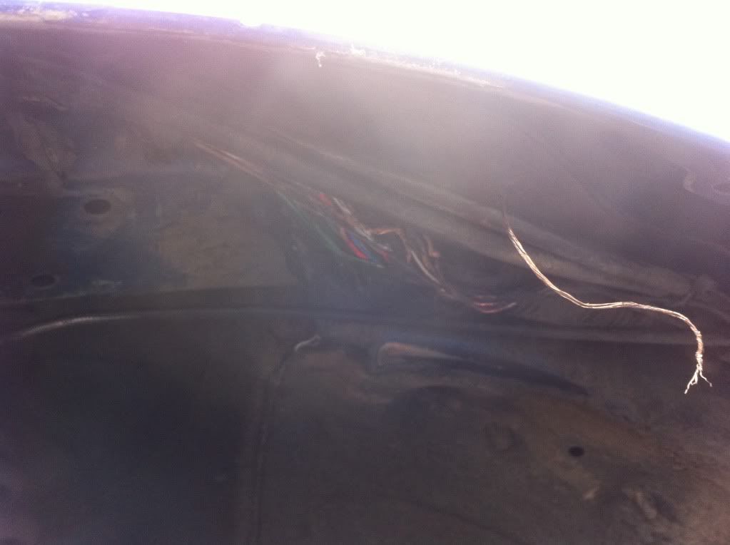

i know what it is!
you have a short on you constant live feed! i know this because my last drift day my wheel decided to eat my front harness where this wire and about 60 more live! i chopped it all up and re wired it and it all worked fine. Then i drove in the wet and my dash lights oil guage lights, SBC light brake and side light would never go off.
looked at my wiring and some had shortend out so i redid it and put more heat shrink on the wires and ita all good now.
Check to see if the wheel has been rubbing. if it has not then 100% water has got in somwhere.

Cheers Mr Tooley - I've advised the auto electrical guys and see what they find. So far they've spent around 40 mins and found nothing grrr!! :wack:
