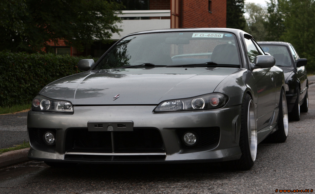

This is how car is sitting atm. Better pics will follow.
Stock non-rolled arches and coils set to 5th. Not hitting on small bumps atleast. :thumbs:

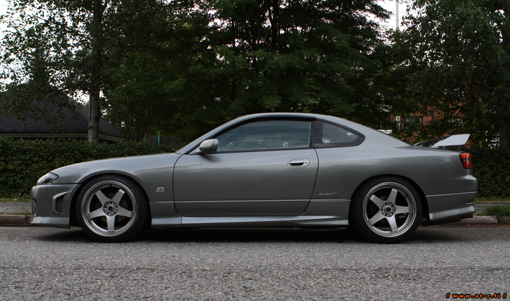

They are...
Front: 18x9.5, ET25 w/ 5mm spacers (Nankang NS-II 225/40/18)
Rear: 18x10, ET35 (Nankang NS-II 255/35/18)

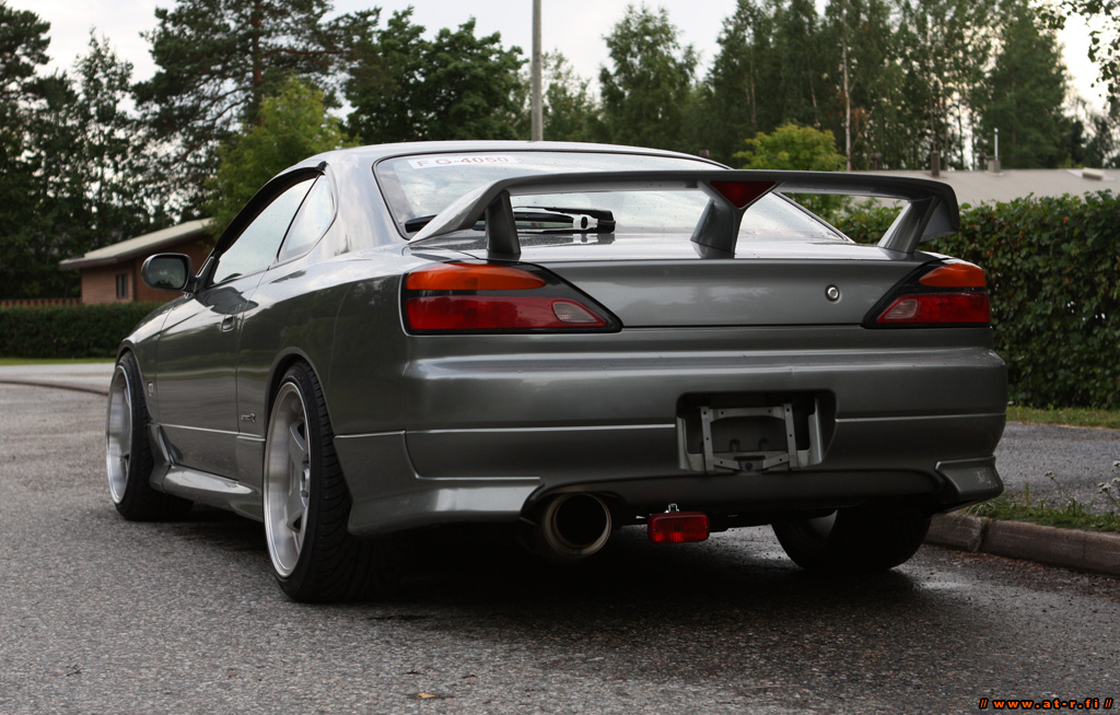

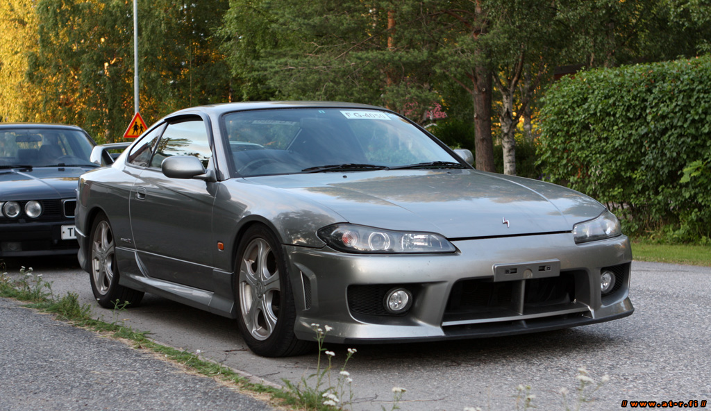

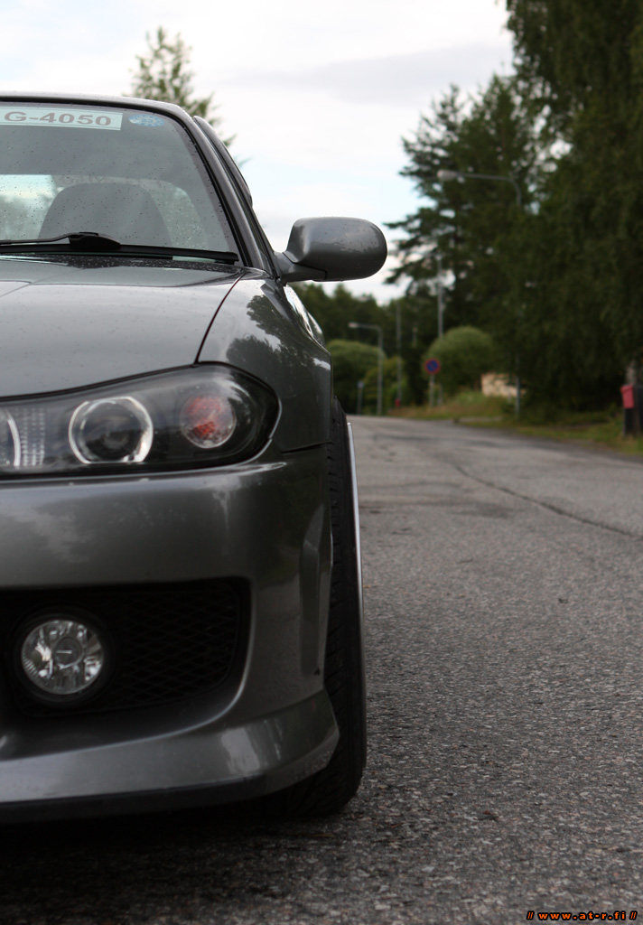

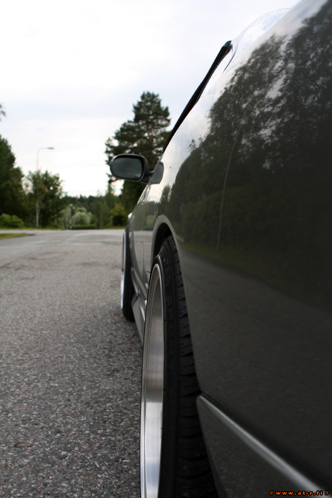

Those better pics as i promised. :)
Closer look at wheel fitment
I think 10mm spacers at front and with bit more camper should solve coilover issue. I'd guess it should be fine even with stock fenders. :thumbs:

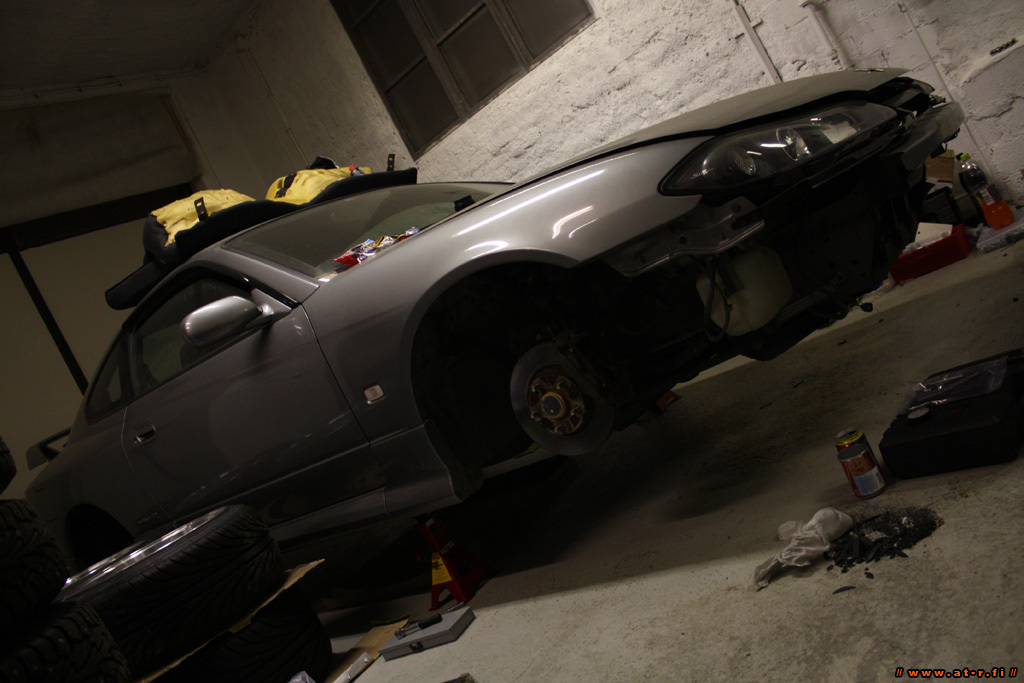

Bit of update on car. It's been in garage since November.
This is how it's currently sitting. :)

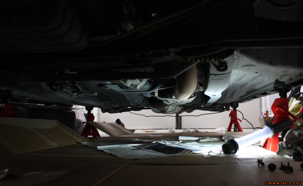

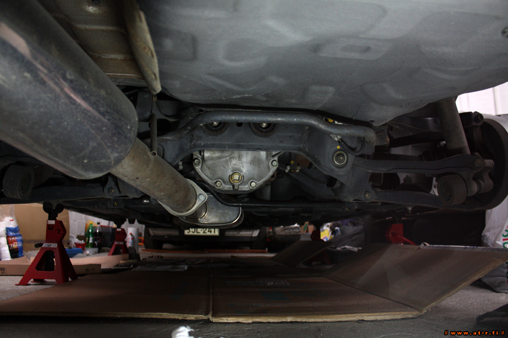

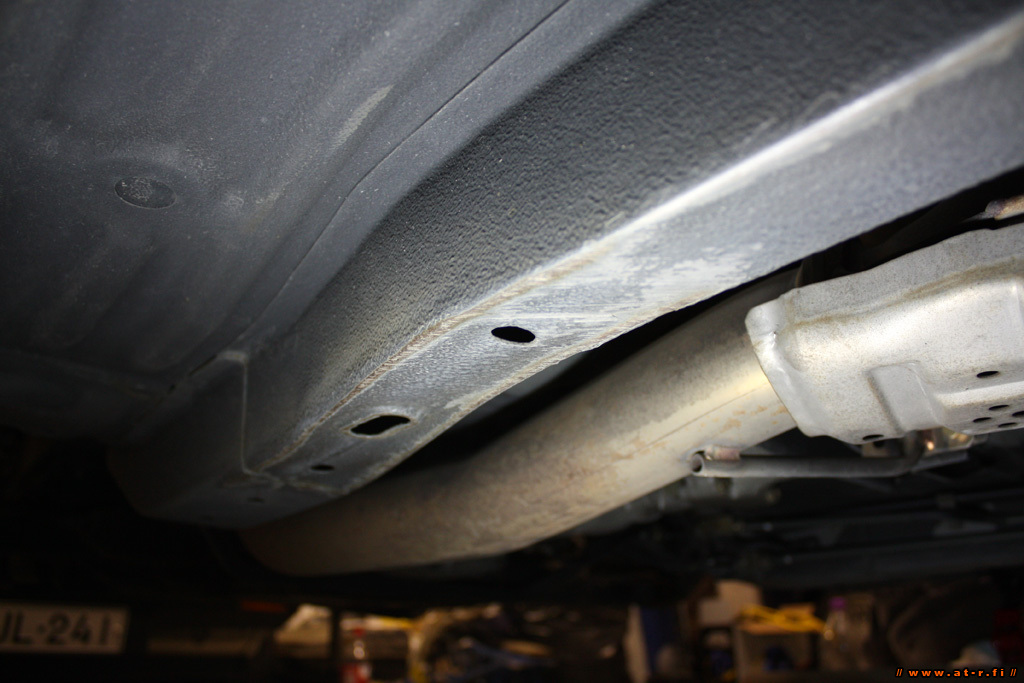

Started doing underbody rust protection myself. Chassis rails have took some damage while in Japan. Nothing too bad, but some rust due it. Front wings and front bumper are bit damaged aswell.
Might need to source new aero front bumper. Pretty hard to find those and most not wanting to ship them abroad. :(

Also make sure you grind as much of the rust away (if any) as you can and give it a decent coat in zinc primer followed by a top coat of something..dont just bung any old hammerite on top of bare metal :thumbs:

Not rust free, but could be much more worse for 10 year old car.
Going to use Wurth rost-stop quattro as primer. Should be great against road salt alone aswell. 1.5 years since painted spot on my s13, only primer and not painted over. Still no rust in sight. :)
As for protective layer going to be using tectyl bodysafe.

Passenger side chassis rail before primer.
Not great pics, but i guess gives bit of general idea. :)
