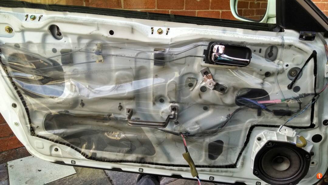

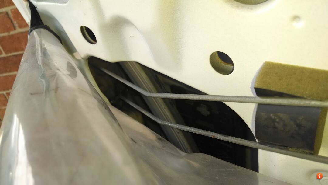

I've managed to take the door apart to see what the locking motor looks like and how it's wired in but as you can see from the pictures below, it's actually mounted behind the actual metal bit of the door and I'm unsure how to safely take this off.
Even if I do manage to get it off, there's still the question of wiring the new one in. Who quoted you £50?
The £200 is an official quote from Toad. Need to try and find a decent alarm place who will do it for me as I'm not paying £200!
