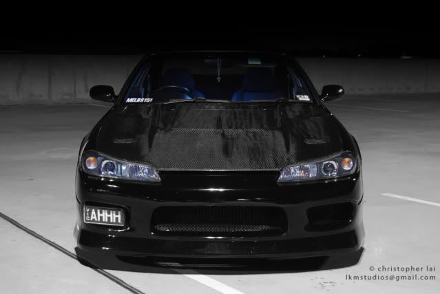

Hi guys,

Currently own a Nissan s15:
Was purchased dead stock, since then completed the following mods:
- cusco front strut brace
- turnflow fmic
- turbo back exhaust
- fujitsubo power getter catback
- turbotech mbc
- apexi power intake w/ apexi heat shield
- topstage front lip, rear pods
- Work VS-SS wheels
- 8000k HIDs
Currently running on a soft 10psi but looking at getting a fuel pump and nistune in the near future to settle with around 200rwkw.
**would like to question running 14psi on my current mods. Because after doing the exhaust I left it on 14psi for 2 days and the car felt so great with the power delivery. Then i chickened out thinking my engine would explode (knock/ping) and turned it down to a sluggish 10psi
Last on the mod list is sadly coilovers.... as much as I would like to put them in, I was sick of driving around very carefully and angle driveways/speed humps in the integra.
Aim is to keep this looking as stealth as possible. A lot of new parts coming on the way... will post more pics as the build progresses this weekend!!!:cool:

Your S15 looks nice! They look mean in black and yours is a perfect example of that look! :thumbs:

Looks like stock bumper with lip attached to bottom (like how I had mine). You can see the middle vertical bar that goes down the front middle opening for FMIC - deffo stock :)
B
blk15
yep its stock front bar with topstage front lip.
Similar to my mates car except he has deleted/shaved the front middle thing.

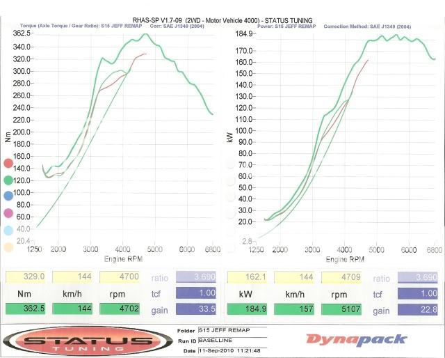

Car was tuned on the weekend. Here are the results/specs for anyone interested :)
Year/Model: 01 Spec S (adm)
Engine/Size: 2.0 SR20DET
Turbo: t28 bush bearing
Power @ boost level: 185rwkw (248hp) @ 15psi
Torque: 362.5 Nm
ECU: Nistune
Modifications: gktech fmic, fujitsubo exhaust, apexi intake, walbro fuel pump, turbotech mbc
My car initially made 162rwkw @ 14psi but was pinging its head off @ 14.5 AFR (massive black smoke at end of exhaust). I was really shocked and the tuner was too. I had previously pumped the boost up from 10psi to 12psi after installing the fuel pump and catco cat. The GFB mbc spiked to 14psi which caused the pinging.
But all is good now with the tune, sits nicely at 12AFR though the coilpacks are on the way out... hence the curvy top end.
You can see it pinging (red)
Now my current concern: i drove my car hard for about a 1.5 weeks at that spiked 14psi before going for the tune... Is it likely that I have done any damage? Should I get a RAS kit etc
